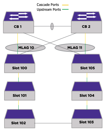

For dual (redundant) controlling bridges (CBs) on Extended Edge Switching rings, you can use cross-connect MLAGs. Cross-connect MLAGS require 48-port bridge port extenders (BPEs) with four trusted ports (for example, V400-48p-10GE4). Cross-Connect MLAG shows a ring formed using CBs connected to a BPE ring using two cross-connect MLAGs.
